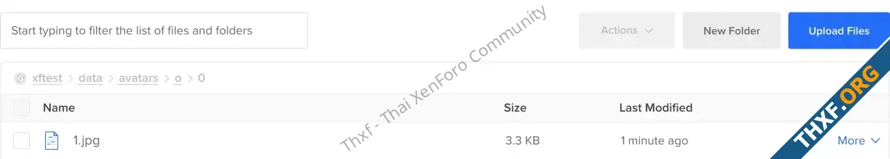

First, we need to test that the configuration works. Simply go and upload a new avatar. The avatar will now be stored and served remotely!
If you check your DigitalOcean Spaces account now, you should see that new folders have been created containing your new avatar:
Success! 🌟 But we're only half way there!
