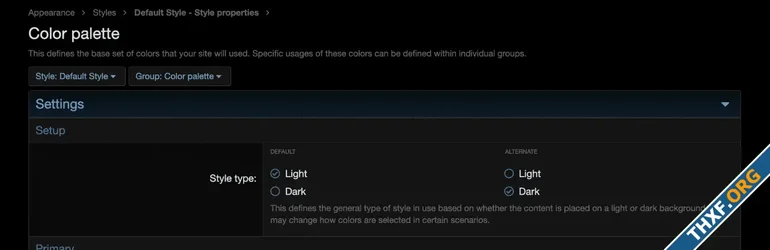

We currently expose two variations, which we dub 'default' and 'alternate'. In the default style, the default variation corresponds to the light theme and the alternate variation corresponds to the dark theme.
When both variations correspond to different style types (that is, light or dark), we expose them using the
media query. This automatically selects a variation based on the device's preferred color scheme when a user has not explicitly chosen a variation to use.
However, you could also set both variations as light or dark. In this case, the gadget in the footer will display the variation names instead, still allowing users to switch to a different color palette at whim.

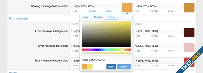

With variations enabled, the user is free to define completely different versions of the color for each variation.
Note that the ability to support variations is limited to color value type style properties and does not extend to CSS-type properties. Of course, that does not mean that CSS-type properties are unable to benefit from the variations system, because the color values they reference may themselves be variants. That is to say, if your header CSS uses
Additionally, in style properties where palette colors are referenced, variations are automatically inherited when using either the default or alternate fields, and can be manipulated using the standard color editing functions provided by XenForo, such as
The color picker has been updated to reflect this change.

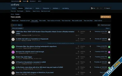

A lot of the new stuff in XenForo 2.3 is related to performance improvements that won't be immediately apparent on first glance, but there is one new feature in particular that is very obvious, and that is the new dark mode.
If the device with which you are browsing a XenForo site is configured to use its own dark mode, XenForo will switch itself to use the dark theme. Alternatively, you can request either the light, dark, or system-controlled theme using the gadget in the footer next to the style chooser. This will switch the mode instantly, without a page reload.

The dark mode is built on top of a brand new style variations system. This system allows defining alternate sets of certain style properties, namely colors, to be switched dynamically without a page reload.We currently expose two variations, which we dub 'default' and 'alternate'. In the default style, the default variation corresponds to the light theme and the alternate variation corresponds to the dark theme.
prefers-color-schememedia query. This automatically selects a variation based on the device's preferred color scheme when a user has not explicitly chosen a variation to use.

Furthermore, while light styles can now be extended to support a dark variation, the same is true of existing dark styles, which can now define a light variation. At present, we refer to the Default and Alternate variations, where Default could be light or dark, and Alternate is (usually) the opposite.

From a style designer's perspective, style variations are handled as part of the style properties system. Style properties defined as a color value may be edited to enable variations, in which case they will accept values for each of the variations defined in the style.

You will notice that we have significantly increased the size of the color preview chip next to these controls, and that the style property editor has become faster to operate, as style property changes are now saved without the need to reload the page.Additionally, in style properties where palette colors are referenced, variations are automatically inherited when using either the default or alternate fields, and can be manipulated using the standard color editing functions provided by XenForo, such as
darken and xf-intensify. Naturally, the xf-intensify and xf-diminish functions now respect the light or dark mode within which they are operating, pushing colors either darker or lighter depending upon the way in which the current variation is flagged.HSL color space
